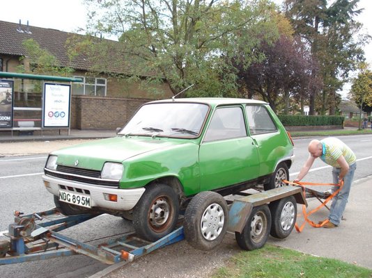

View attachment 14672 image.jpg View attachment 14672 View attachment 14672 image.jpg Hi all, I have recently brought a little 73 5 tl (ndg895m) it's been lowered and this is my 1st issue as it scrapes the floor, can anyone help or advise on how to return it to correct higher and tension the torsion bar on the front? Also I have a leaking camshaft seal and can't find a replacement anywhere, if anyone could point me in the right direction it would be great. I have a list of other parts Iam after in the near future that I have had problems finding so far...

If the camshaft seal is leaking you need to take gearbox out unless you've got special tool
Not sure I've got one
Seal will be same as R4 1108 once you know dimensions easy to find on ebay
My contact details on here on profile or whatsapp or facebook
I know of a mk1 5 due to be scrapped imminently so ASAP would be good
My number is 07857495800. The box will be out as soon as I get the car back from bexhill as the clutch went last night and now got to tow it back to haywards Heath
Is it original engine as probably got 160mm clutch think ive got new one if I didn't bin it
Probably got seal as well
Sorry I didn't call last night had to sort out towing the 5 back from bexhill to Ardingly. Will give you a call around 11ish if that's ok?

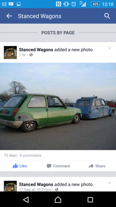

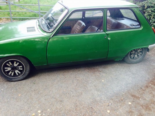

She does get about! Thanks to Paul she is now back on the road with a nice new clutch. Hopefully won't be to long untill she is rust free and looking and driving like new
This was once my car (pre-lowering) I'm so pleased she survived and is running once more.
