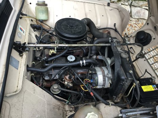

hi gentlemen, thanks for the suggestions. This is a photo of my engine bay, and I have looked at the alternator and compared it with pics and think that its a Paris Rhone model, can anyone confirm or otherwise. I was going get new brushes from Franzose, and I need to know the type. I sent the photo to them, and they replied that if it is a Paris Rhone model.. rather that it is a Paris Rhone model, which did 'nt help me. If someone can confirm it that would be great. Thanks. This ability to ask detail questions and get well considered answers is fantastically helpful, so thanks to everyone.
