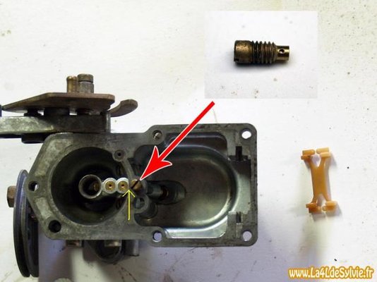

This might help too http://www.google.co.uk/imgres?imgu...enith+28if&um=1&hl=en&sa=N&ndsp=20&tbs=isch:1
The yellow arrow indicates where all of my air leaks came from.
oh, yes, the yellow arrow, i remmember last saturday when i made the gasket, y cut lot on this point. Next saturday, i take off the carburetor again, and made a new one, take some pics...
