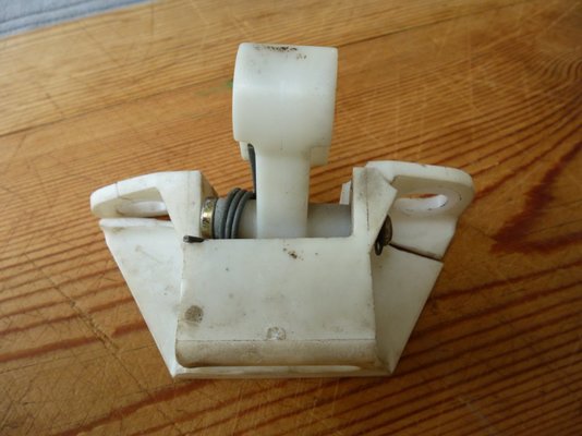

Thanks for that. I discovered how difficult they are to remove yesterday afternoon, when I gave up and decided it'd be best to leave the plunger in place!
The problem is that the plunger is loose, which has caused a really annoying rattle - I think this was a fairly common problem on early 5s. Is there an easy way of stopping the rattle?

There is supposed to be a spring inside there the mechanism is the same setup as r6 and r 12

This part turned out to be the culprit - I noticed a small crack in it yesterday, but it's completely had it now.
Does anyone have a spare one?
