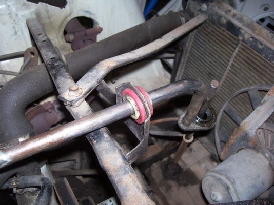

Ingo must be talking about a process of letting liquid PU polymerize in the bushing, not melting already solidified one and pouring it in. This should be a far better process than machining a rod as it leaves a smooth outer surface, and can produce shapes difficult or impossible to make otherwise (like the anti-roll bar to chassis rubbers).
My priority list...Steering rack to track rod bush (for pre-79 cars), anti roll bar to chassis bushes, as they get oil soaked, lower wishbone tie rod bush, and perhaps some of the early "introuvable" stuff.

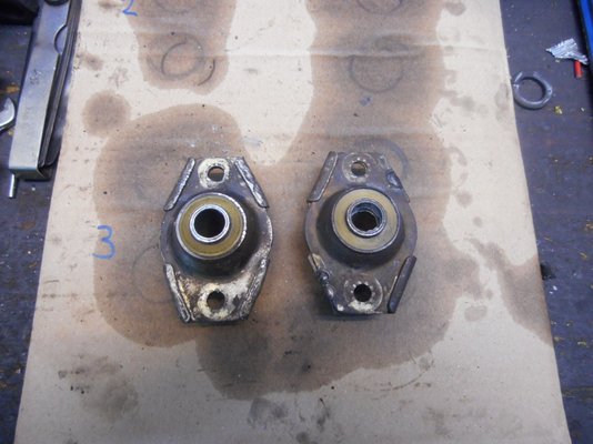

I'm digging out this six year old thread to keep you informed on my latest progress on the poly-bush issue. I fabricated this pair of tie rod bushes by splitting a pair of worn bushes in half, machining the rubber part in 85 Shore hardness polyurethane, and reassemblying the shells.
The result seems very promising, I managed to fabricate the bush to the correct shape and dimensions, which is critical because it has to do a 3-axis movement, unlike convenional bushes.
I am going to make one more pair and fit them on two R4s in order to see how they keep up. Stay tuned :-)
