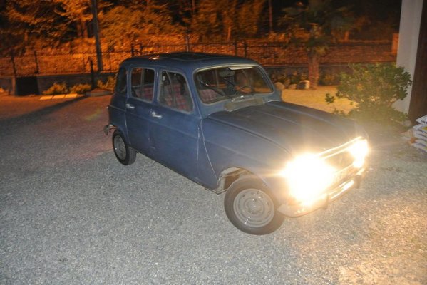

Looks like I will be back on the forum for quite some time (been away on a Citroen Traction project) as my son has just started the preparation for the 2016 4L Trophy. We have decided to use his current 4L a 1983 TL which is in the thread below, we we bought 2 years ago and it has been a fantastic "beat up" little car.
