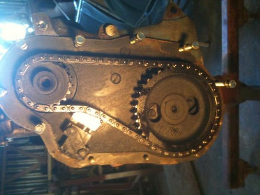

Nearly have engine stripped, according to the manuals, there are timing markings (holes) on the timing gear outside faces, but this one has nought.
Should I just mark current positions and remove?
Plus what warrants chain replacement? It's a double chain photos-
Steven

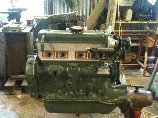

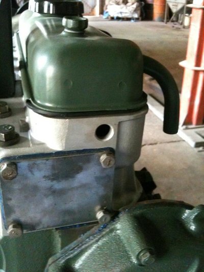

I've almost got my motor back together! Had a blip with pistons as the ones I ordered through Franzose had different gudgeon pin size, mine were 14mm and the supplied were 16mm. Fortunately JP Pistons here in Adelaide had the right spec and very nice too. Price was alot more though!
Anyway the head has a plug hole at timing gear end and wondering what's around to plug it! I read there was a rubber plug in manual.
Looking forward to going over to July Thenay meet, wanted to know if anyone might be driving from UK or Paris as I'd love to hitch a ride!
I am finishing off this motor at present and will hopefully have it running by end of Feb.
Look forward to hearing from anyone with suggestions and possible driving, you never know I might be able to help get your R4 going if it breaks down!
Regards Steven : )

Nice colour!
There used to be a rubber plug there but as these are no longer available now, you can make a close-fitting plastic plug and use some RTV sealant as an extra precaution.
The other solution (but I guess it's too late now...) is to drill and tap the hole to M12x125 thread and use a threaded plug and copper washer, just as the factory did on 4CVs and Dauphines.
Rockin good doopsy will flex the paypal asap!
