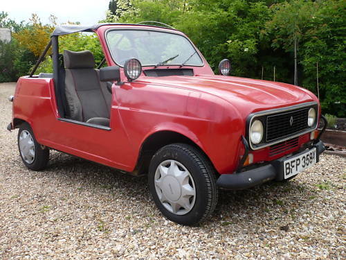

My little buggy would also like some nice wheels and an original steering wheel. I'd like alloy wheels because the original steel wheels aren't good and I think I could get away with it as this isn't a true "classic"! Can anyone help please? Steve.

There are 3 choices of alloy wheel I can think of - all of them come from Mk1 Renault 5s.
Worth a search in Google images or similar for the Renault 5 Alpine or Gordini, the turbo version of the same, and the Renault 5 TX to see which you like.
The Alpine and Alpine turbo wheels are fairly readily available and a reasonable set might be around £100. Try to get the wheel nuts too - they are specific to Renaults and different from the ones you have.
