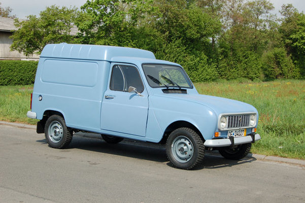

Hi there,
I was wondering if there are any R4's on the road in the US of A.
I'm planning on relocating to the US within the next three Years.
As my little R4 van became more and more a family member than just a car to us, I'm thinking of taking the F6 with me.
But I have to check up-front if there is any possibility to get the car on the road in the US.
Are there any members from the US on this board?
What kind of modifications would a European (actually German) R4 need to get it to the US-streets legally?
Any hints, tips and tricks for me here?
Is it much of a conversion?
Would I need side-marker lights?
Any special bumpers?
Different headlights?
An MPH-speedometer? (And if so, could I use one of a UK model?)
Your help would be really appreciated !!!
It's a std. 1985 R4F6 van with the 1108 engine.
Thanks in advance!
Cheers,
David
