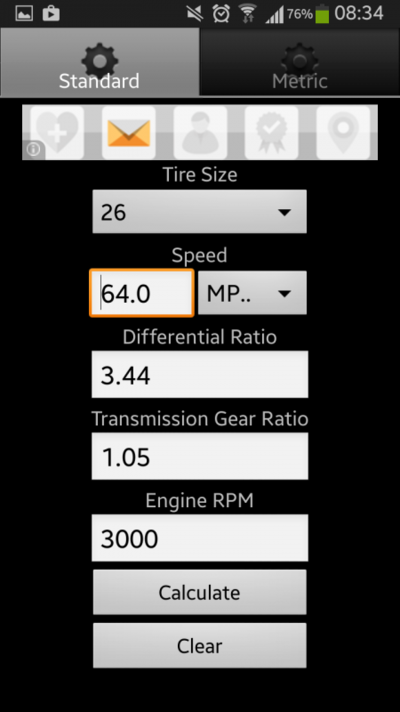

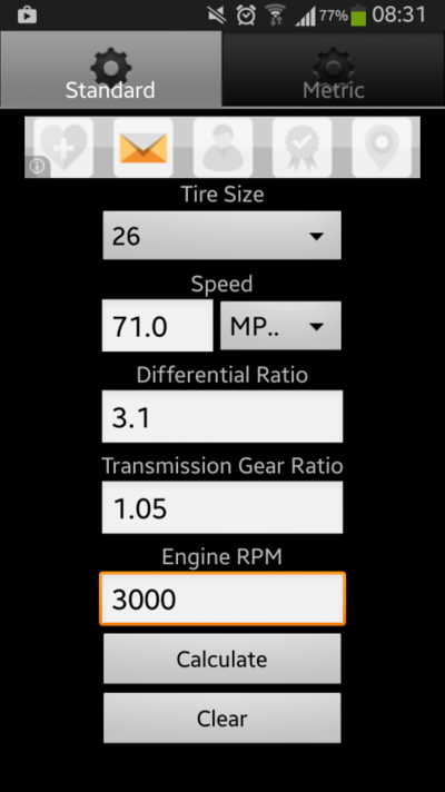

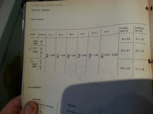

Screenshot_2014-11-11-08-31-25.png Screenshot_2014-11-11-08-31-25.png a very quick reply as am a passenger in a vehicle at the moment and have never had 5 notifications to come in onthis forum at once before Ole ha1 5 speed gearbox is in use hi gear ratios the difference is in the final drive or differential ratio as it is called sometimes depending on code you can have 4.125 3.44 the best books for relaxed cruising is from tl/gtl 1108 cc R5which has got a 3.1 ratio in i am going to attach the page from the gearbox manual and will discuss in detail when i have got more time and a decent wifi connection20141103_072537.jpgScreenshot_2014-11-11-08-35-35.png
