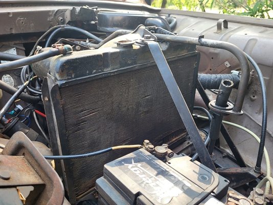

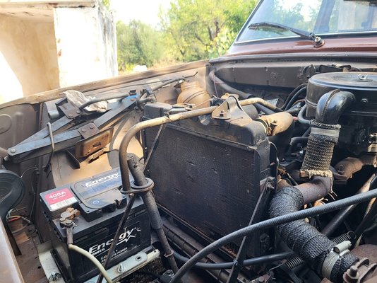

The lower hose connection is on the same side as the upper, isn't it?

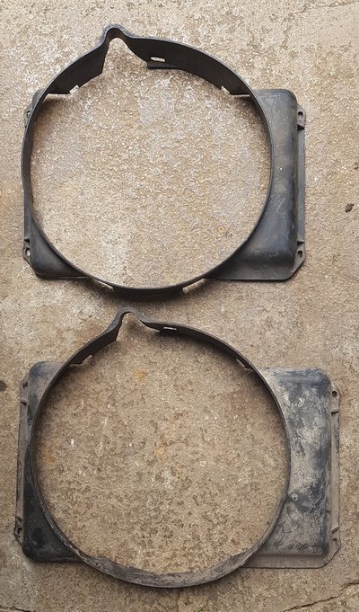

It's worth checking the dimensions of the radiator carefully - R4 850 radiators came in 2 widths. I haven't got any spare radiators to hand, but you'll see the difference in the plastic fan shrouds in this photo:
The smaller one (probably like yours) is c. 384mm wide, the other 427.
