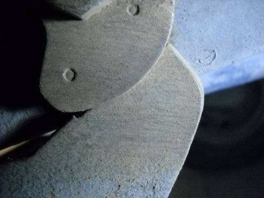

I just find what I may describe as a cam attached to the rear torsion bars of my car. Does anybody knows if they are to adjust high?. I have read on some other threads that this is made by moving some splines the bars after some heavy work.
Does my my car have another type of adjustment (Easier) ?.

Yes it's the earlier (68-77) method of torsion bar adjustment, and you guessed it, you simply rotate the cam to adjust the ride height.
A similar arrangement is also to be found on the front torsion bars.

It can be done with the wheels on the ground, too. The cams are held on the opposite side of the chassis with a nut, loosen this one turn, or else the cam will not move!
Depending on the amount you need to raise the ride height, the cam may run out of travel, and you will then need to reposition the bar on the splines, but it's still easier than on later cars.
