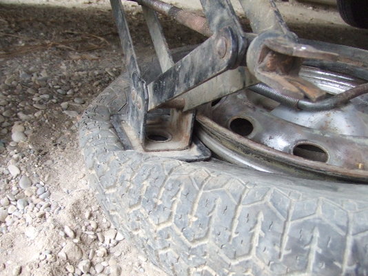

I tried this method (see photo) with a jack and popped the seal in 5 minutes.
Taking the tyre off was a bit of a sweat. After getting one makeshift tyre iron between the tyre and the rim, I put another one in alongside it and hammered it sidewards.
Now I can get on with the painting!

Yes, that's a good method, nice to be independent isn't it, and not have to rely on others that are not really interested in helping you. When you have refurbished your wheels use plenty of soap and you can refit the tyres yourself, job done.:smile:
