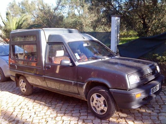

Hello, I ve just joined the forum in the hope that I can get some help in identifying the Renault Express I've bougth in Portugal.
It's a 1993 model 1.2ltr petrol.
Anyone with any info? Is it based on the R4?
BriW
No, based on the 2nd generation R5 with transverse engine but a nice, practical car in the R4 mould. Enjoy!

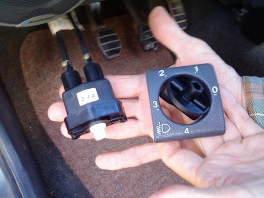

I wonder if the deisel model has this, attached, type of headlight dipping mechanism? Mine does'nt work, it just rotates and springs back. No movement at lights. Is it liquid filled? can it be repaired ?
BriW
They are normally cables which are twisted along its length, if it twists and springs back you will find that either the headlights mechanism or the cables at the headlight end are seized.
It wouldn't be a vehicle test failure here in the UK, the mot test just requires them to be level at mot time.
For me I have them on my works vans and we never adjust them.
