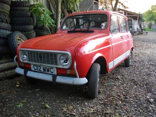

Hello team,
I saved (with cash) this GTL about a month ago which was local. I went to look at it expecting the usual wing rot and no floor etc etc but when i arrived it was in supprisingly good condition with the cleanest interiour i have ever seen, it even smells new and i love it!
It did not have a battery but i figured some one had probably robbed it, but this did not put me off because the car looked so clean so surley the engine had to be purrrrrrfect too...

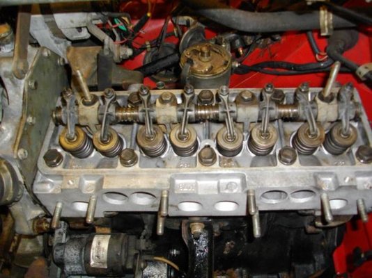

I decided to remove the head knowing i would need to fit the clamps so i didn't dis-lodge the 'chemise' (liner?) and with in an hour it was off. EEk i think half of the water from Le Moulin Bodin was in the middle two bores (i should have spotted the fact it had no spark plugs in when i bought it) However after i began to soak it up i found it to be a cheap form of WD40.
I fitted the clamps and tried to turn her but no, locked solid, so i rummaged through the scrap metal heap and sought myself a fine piece of 15th century ironmongery. Seating it sweatly into the clutch i gave it the hardest hoof i could and CLONK, IT MOVED and the camshaft with it, yippi. (i did wonder if the chain had snapped)
This is how i left it, with yet more h'uil in each bore whilst i voyaged down through the snow to Ian's toasty cottage to repair his BX. The amount of oil this car has had down its bores is more than a life times worth, i should look into getting some shares in Mobil Exxon.
Alot of Wine and a while later....

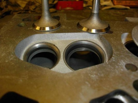

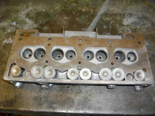

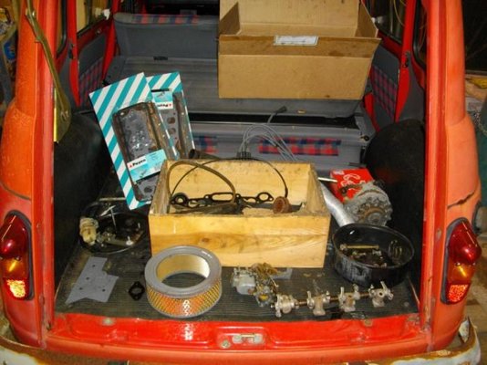

Last week i took the head into work and fully refurbished it and yesterday found myself with some free time so i put it all back together. P.S the bolt under the starter motor is a right (naughty word) to remove, why did Renault use a bolt with a 13mm head and a nut that is 12mm?
I have not started it yet as i want to flush the cooling system out. My plan is to do this on tuesday evening as hopfully the new exhaust system will be here by then.

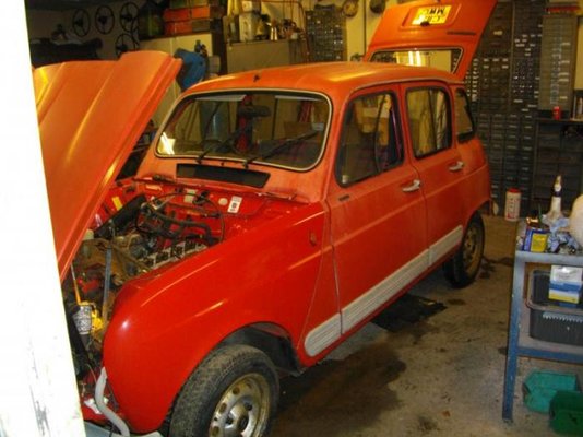

Sorry, Yes in short it does run. I have so far only run it for about 30 seconds a time as the new exhaust system is not fully fitted yet, but it certainly seems to run ok. The first time i tried it, it started on 3 cylinders and then the 4th cut it, now it comes in almost straight away.
Ideally i need to get it hot (+ to check if the fan switch works) I will probably finish the exhaust off on weds or thurs, then fill it up with anti-freeze and take it out into the yard and leave it running for a while.
Another possible job i have found it the clutch. I dont like the feel for the pedal, there is hardly any travel and biting point is right on the floor so i might have to put a clutch in it yet (the pedal is also heavy to press) If i do end up fitting a clutch i will take the whole engine out and fit a new timing chain while i am at it (like i did with the F6)
Its only about 14 bolts, a few cables and drive shafts and then that way i could clean up and paint the engine and engine bay. Then its just a matter of freeing the back wheel cylinders off and cables, adjusting the loose wheel bearings, head-lamp, etc
So thats where i am currently at. Running but only tested.

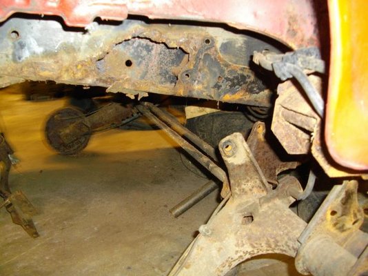

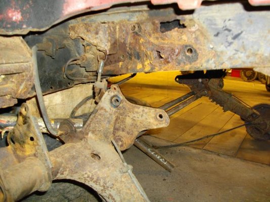

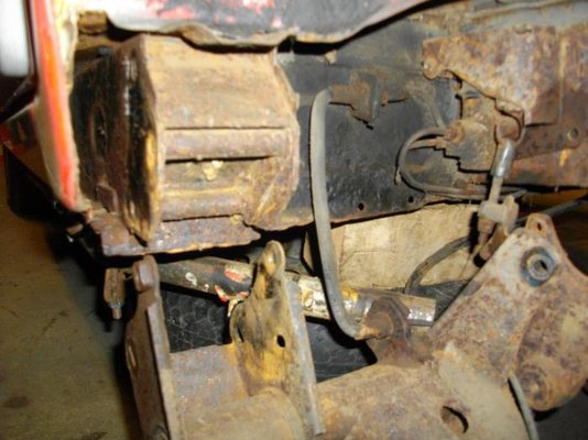

Any way its all running like a watch awaiting its service now, however i was poking around the back chassis and noticed a few bubbles so i prodded them with a 16th century hefty screw driver and dunk, straight through it went. The bubble turned into a hole the size of your fist.
Up it went on jacks and i removed both rear wheels and shock absorbers I then sat on the spare wheel thinking about what to do and how to proceed, then before i knew it i was half way to removing the whole torsion bar.
Removed spare wheel
Removed spare wheel carrier and tank guard
Removed tank (still half full)
Loosend outer M8 bolts on each side
Loosend inner bolts (one is quite big)
Then i jacked the car up to a sensible working heigh and positioned two axle stands under the rear chassis just in from the bumper. I then removed the outer M8 bolts and removed all of the inner bolts except for the 2 big ones. I then found a punch on the chicken run floor and gave each bolt one quick blast (because i was scared it was going to fall to the floor) The bolts just shot out across the workshop floor and the axle stayed in place.
I laid my hand on it and with the softest touch it fell down. Note i did not disconnect the rubber brake hoses just incase it did fall. I will be replacing these along with the hand brake cables.
I chipped away like a wood pecker making a mess on the floor until i found good metal, which i did. Odley it seems to have only gone on the drivers side and the wheel arch stiffners are fine.
So thats where i am up to now. This is my first torsion bar removal and i am quite pleased with myself. I did all the work on my own in one afternoon. I will post some pictures once i have swept up.
Having removed it i think it is now quite an easy task, plus the repair will be very neat and long lasting. Another R4 saved, Mr Scrappage scheme :cool:

Hello, the outers are absolutly fine its just the drivers side rear chassis (just behind where the torsion bar bolts on) has a hole in it now.
Torsion bar removal
Yes this weeks task was to weld up the rear. Here are a few pics of what it was like when i removed the bar.
The outer chassis sections are in superb condition.
