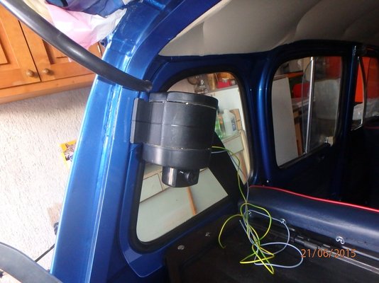

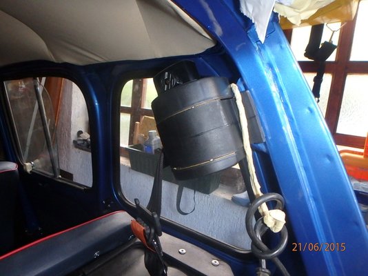

I have put rear automatic seat belts from securon
They can be set to work in any position. And working nice. Sometimes they do stuck if you pull them suddenly but that is what they should do anyway.

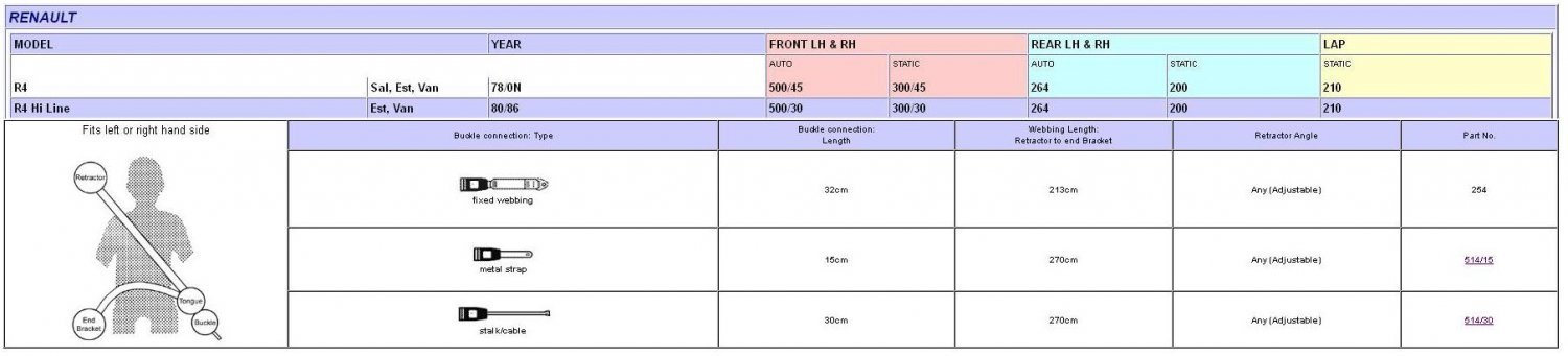

Securon have front seatbelts also
Here is what they offer for R4.

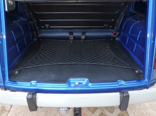

And here is how those rear seatbelts are standing in car
