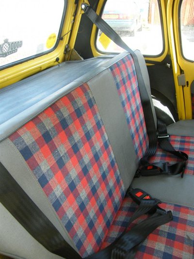

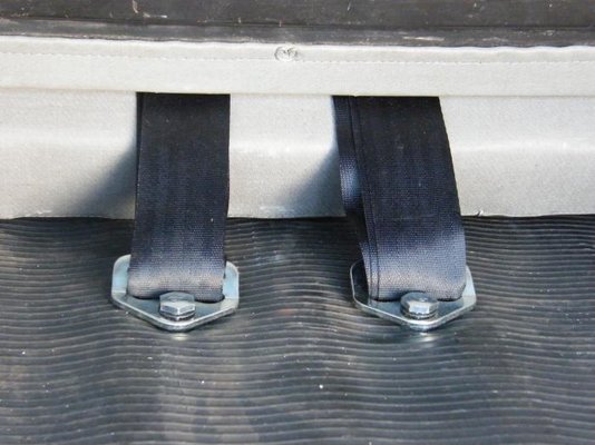

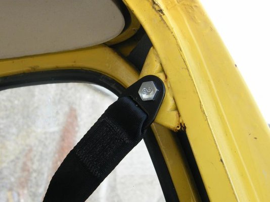

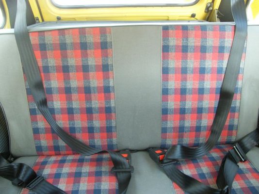

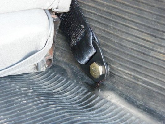

Well,that's the belts fitted,a worthwhile job and so easy.I just had to drill a hole in each inner wing,no mounting sockets there,I expect there had been some repairs done in the past in that area and they were removed,but all other mounts were intact and rustfree. I just happened to have some suitable drilled plates in stock where I bolted through the inner wing,to reinforce it,very necessary,but Securon can supply plates with welded sockets fitted and they suggest welding them to the car which makes sense.For anyone interested in fitting these seat belts their part number is 200.For reel type belts the number is 264.They do front belts too for the 4,infact they list Renaults back to 1955 with the Fregate. Couldn't resist adding a recent picture of Marigold reunited with her previous owner Abi. :smile:
