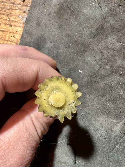

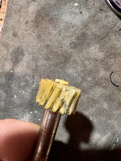

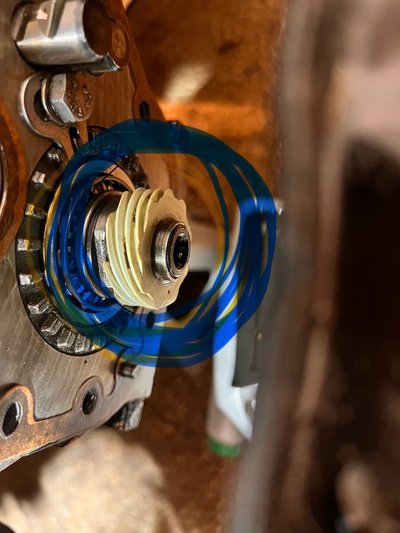

I’m looking for speedometer gear with 16 teeth, can anyone help me?
And if anyone knows how t take that off?
The part mark blue

The gear on the mainshaft is actually a nut. There are two flats for an open end spanner between the gear and the bearing - visible on your photo. The spanner size is 29mm if I remember correctly, but needs to be ground down until it's about 3mm thick. This nut is also staked on the mainshaft at its outer side and this needs to be undone first.

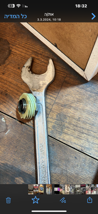

Finally it’s done
My friend found me from r5 set with 16 teeth
