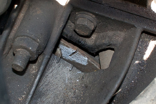

The photo attached shows the notch which I had interpreted as the flywheel mark (highlighted with white pencil), but my local mechanic says there is supposed to be a pointer bolted on somewhere. Any ideas?

I really really WISH I could get some reliable info on these marks as well !!!
You won't find a bolted on pointer on the late engines, just these marks everywhere... :(

Early cars had pointers but the GTL had marks just like yours. I generally line up the notch in the flywheel with the notch in the middle that it's closest to in the photo. If it pinks retard it a little from there.

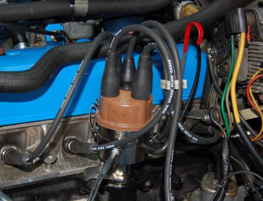

I recently installed the 123Ignition and I can absolutely recommend it!
I had initial problems to find the right setup (there is no pre-programmed advance curve specifically for the F6 engine), but I found a pleasant solution meanwhile.
The 123Ignition indeed helps to stabilize the timing-mark on all RPM's.
As a great advantage I see the improved performance of the engine @ lower RPMs.
It runs smoother, cleaner, and more "stable" than with the traditional distributor and points.
I can drive the F6 in it's 4th gear now at about 40kph (25 Miles) with no problem! Going through tight turns I now rarely have to downshift the car.
All in all the R4 with the elcronic ignition feels more like a "modern" car to drive.

You can just note a series of lines under a layer of gunk immediately below the head of the bellhousing bolt. These are the pointers. You will notice that the two extreme lines are larger, the left hand one (when viewed from the front) is TDC, right hand one is 6 degrees BTDC.
Just to confuse your mechanic, and remind him he is working on a French car, three more marks are visible on the front part of the timing window, also apparent on your photo. Viewing from left to right they correspond to TDC, 6 deg. BTDC, 12 deg. BTDC.

I know those marks are there, but I can't fit a wire brush in to clean the gunk off!
But I think the mechanic was talking about a marker on the flywheel, not on the bellhousing.

I would love a 123Ignition but it is really very expensive, I think I will have to try a £30 PowerSpark kit instead.
I know, I know...
I tried an electronic ignition kit that replaced the points in the original distributor first. (Was about 60 Euros).
Worked exactly for one Year. Then all of a sudden it was toast and left me dead in water some place far from home.
I dropped the ~300 Euros for the 123-Kit and never regretted it!
The electronic ignition kit already was "better" then the original setup, but the 123Ignition exeeded it by far.
I combined the 123Ignition with a Flame Thrower coil and that setup is probably the best you can do to your engine.

I have ordered a cheap electronic ignition kit, but my first attempt at fitting it ended in failure when I somehow got the ignition leads mixed up. I will start again when I can borrow a timing gun (see below) but this time without that stupid mistake. I blame it on this stinking head cold, I can't think straight at the moment.
A few points came to light that were not mentioned in the kit's rather sparse instructions.
  • In a late Ducellier distributor with vacuum advance, there is a small toothed cam used to adjust the tension in the vacuum unit return spring. This fouls the magnetic trigger ring that should fit over the original points cam. It looks like you can grind off the part of this wheel that gets in the way without affecting its function, unless your spring is really weak and requires the maximum tension setting.
  • The old wire from the points to the coil negative side can be discarded, but the wire from the positive side of the coil to the battery stays where it is. The EI kit includes connections to the positive and negative sides of the coil.
  • The electronic ignition kit does not appear to allow static timing, because the circuitry doesn't switch the coil on unless the engine is turning at several RPM. Hence you won't get any response if you try static timing. Don't try fitting it unless you have a timing gun available!
I will attach photos to illustrate these points once I've got the kit properly fitted.
