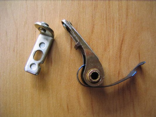

Hi Cyderman
If the points you need are the ones in the photo, I may be able to help. The part number is Intermotor 2287[0]; they replace SEV 908247. I've found 5 brand new sets, which might keep you running for a bit!
Andy
