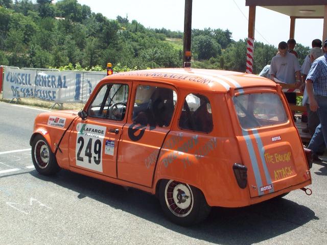

The alloys on the orange 4 are Mk1 Renault 5 Gordini Turbo alloys. I'm greedy and have 4 sets of those! Also have a 5 TL with the 5 speed HA1 box which takes the top plate from the R4 gear box for the over the top change.

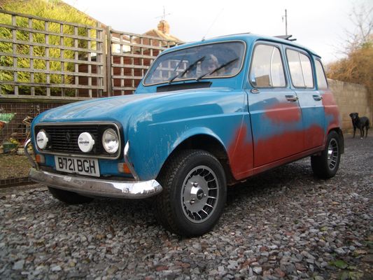

I have the same Gordini Turbo alloys I think you're looking for. I bought them last month and have since put them on my GTL replacing the standard Gordini alloys.
I am currently trying to turn my GTL into some kind of GTI Gordini. Its quite a big project and it still needs lots of work like a full respray, interior work and an engine transplant (I have a 1.4 from a R5 TS waiting in the garage!)
The turbo alloys should pop up now and again- keep an eye out. Heres a photo of my car so far. The wheels dont look bad plus they have pirelli p6 tyres on.

Do they clear the rear arches when the suspension compresses?
