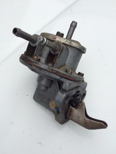

Mainly the "problem" occurs only in the combination 1108cc Cleon engine with the Zenith 28if carburetor.
With my first R4 GTL 1983 I never had any problem because that particular modification was already installed as the 1108 cc Cleon engine needs a 3 lead fuel pump not the standard 2 lead.
My second R4 GTL 1985 (still in full restoration mode) came without modification and the problem as you describes occured as well.
Maybe buying the original 3 lead GTL fuel pump and installing the modification may solve the problem. Ofcourse in combination with the period correct type of fuel, so don't use the nowadays dreadful terrible E10 types of rubbish fuels.

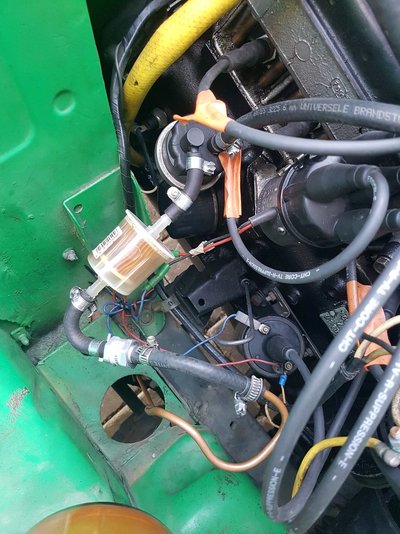

Hi, i had always had same problems but finally i got it over, i installed a cheap one-way "valve"(it's the silver thing before the filter in pic) plus big one petrol filer before the pump and now it fires up by the very first attempt every time.
i also tried to adjust the aftermarket pump distance from the connrod by reducing the 4mm distance piece to approx 2mm's but it only made the float chamber to flood !
Good solution indeed and nice to see a fuel hose which the Dutch text "Universele brandstof" :)
