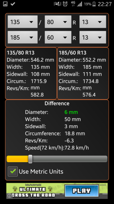

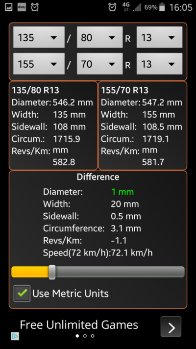

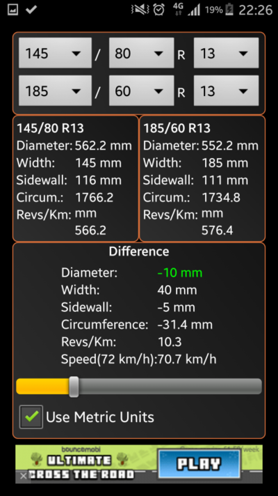

Screenshot_2015-10-04-22-27-16.png Screenshot_2015-10-04-22-26-49.png Screenshot_2015-10-10-16-05-32.png Renault 5 gordini or alpine in Europe uses 155 70 13 as fitted new from factory they fit fine
And clear bodywork easily as rolling radius is less than 145 80 13
These are a few screenshots from an app from Google playstore on my phone as examples
