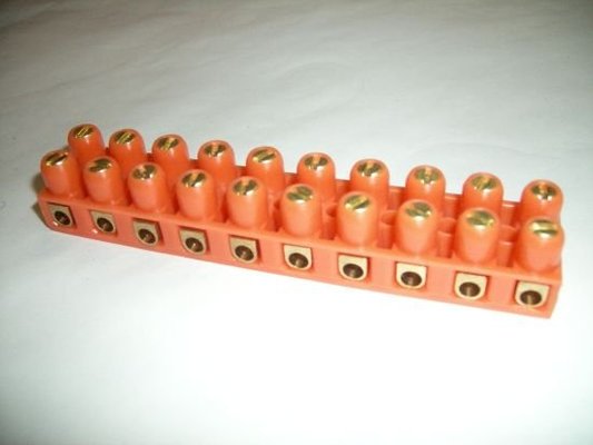

I have also joined the two broken pieces of original wire together with an electrical conector, cut the plastic outer off and there's a lovely little brass wire holder inside that's just the job for connecting broken cables back together.
