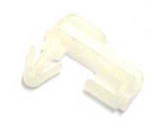

Hi everyone,
I am replacing my throttle cable as all frayed and sticking.
The original cable has a plastic "clip" for the pedal end attached to the cable with no way of removing.
I have obtained a new general bicycle cable but struggling to find a suitable mechanism to attach to the pedal. neatly. I fear just using the bare cable will wear it out.
Some of the replacement cable kits include the attached clip for the pedal and cable - are these available separately (and without 30EUR postage) in the UK?
I have designed one of these and 3d printed one to accept a bike cable, will attach a photo shortly, it’s just under test at the minute!
