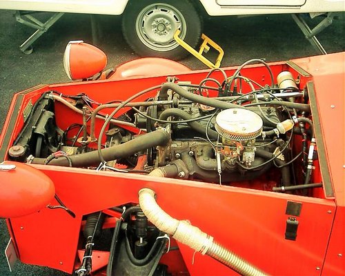

Other changes from standard are a 'cut and shut' exhaust pipe to route straight outside the bonnet, and a fairly simple exhaust system that uses stainless steel pipe and a single 'cherry bomb' silencer. I'll try and attach a photo.
After retiming the ignition to Clementines recommendation of 'between the timing' marks, I went for a run this afternoon and the performance seems a bit better. Still a very slight hesitation on light throttle, but a fair degree of acceleration once its past that point. Mind you, there should be, the thing only weighs about 440kg unladen. If I can get my confidence up, I should be more than capable of giving the 2CV trikes a run for their money.
This carb is exactly the one they supplied to me and you have made it fit in exactly the same way I did. I even bought the pancake filter from them as well. I can see that, because of the bonnet line, you can't fit the R5 IF32 set-up so you have lot's of playing around to do. You could try replacing the main jet with a larger size as it will run weak with that filter, or by fitting an air filter that is more restrictive. Good luck!
