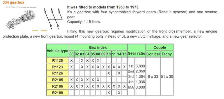

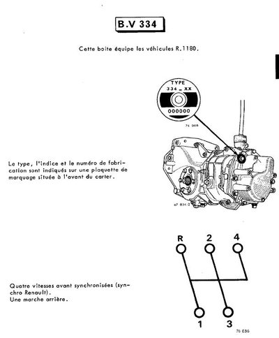

Hi Guys,
I'm cleaning up (mild restoration) a 4-speed 334 gearbox to replace the 3-speed on in my '64 1123.
The identification tag on the box says it's a 334-06.
I haven't had any success in finding out which vehicle model this box came from, and what might be different about it compared to others.
Might be an issue when getting parts.
I got the box from a deceased estate so I can't query the source as to it's origin.
Does anybody know what it might have come from?
OR any documentation referencing the 06 variant?
Thanks, Geoff
