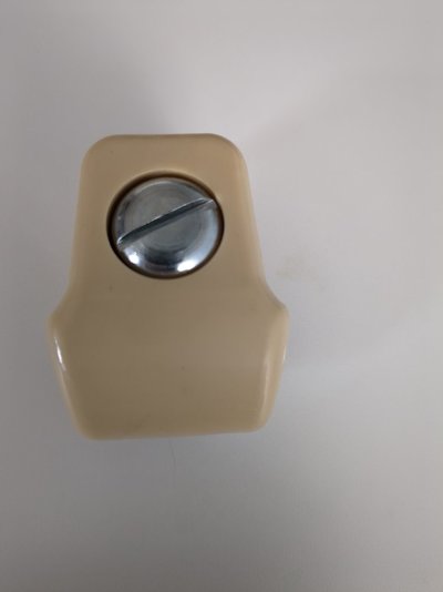

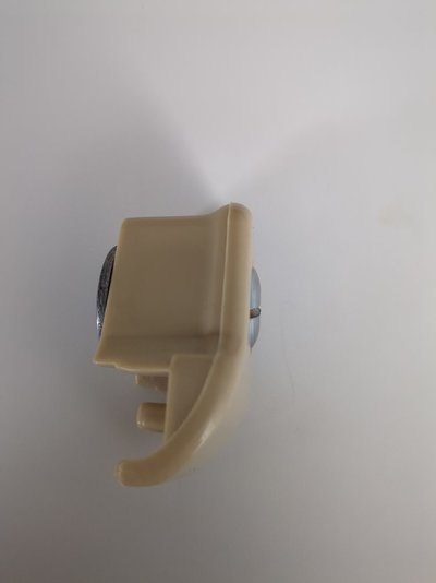

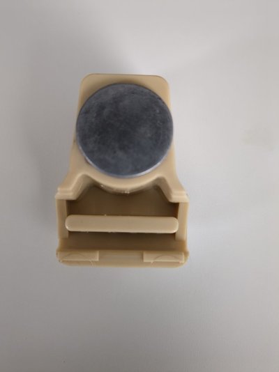

4l window slider button.
Elwood
42
South west
Can't find any description anywhere as to how to fit it. Is the round metal disc meant to stick to the window as I would imagine that's a big ask, or have I got a bit missing?
16664380064109079249027847062516.jpg 16664380286877915713215365097236.jpg 1666438041518609358498924300705.jpg
There are a couple of different types. Where the inside face is curved like yours it is intended to sit on the other side of a hole in the window glass. Later cars had a flat inside face and that was designed to be glued to the outside of the window.
Thanks very much for replying, so it is no use to me then I presume as I have no hope in the glass.
