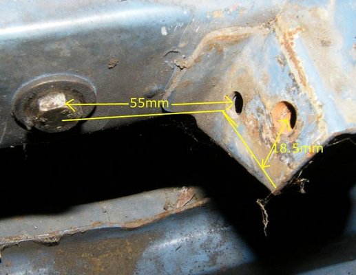

As the chassis is home made I’m having difficulty checking the ride height is set as specified or using the rule of thumb principles for adjusting the steering rack.
The upshot is that I need datum points to work from. These being the, R1128, distance from the chassis lower suspension fixing bolt to the bottom of the chassis, so I can set the ride height and the distance from the top mounting bolt to the centre of the rack on a X Y axis.
I used a couple of Malcolm’s photos, to illustrate what measurements I need.
Also a few of how the rack is mounted at present. “I’ve put them in My album as I can’t work out how to put them in this post”.
With this data I can then have some chance to workout whether the rack is in the correct place.
