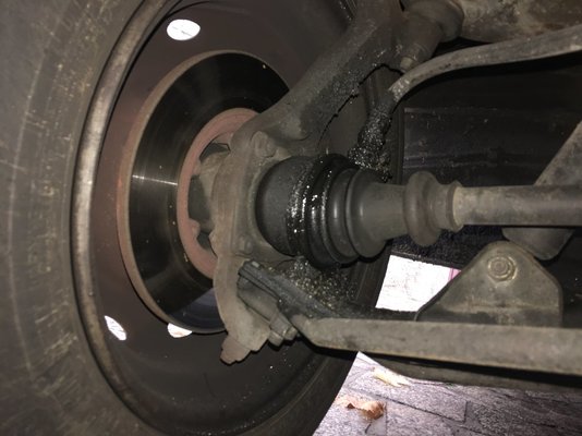

Enjoying the ride to the beach, with my foamy strapped to the roof of the 4L, when out of no where came a horrible metallic grinding sound, killing the good vibrations…
Any recommendations on what parts, tools, I would need? … please see pic.
Thanks!
Looks like your driveshaft CV has failed, if you have a standard metric socket set/spanners and a ball-joint splitter tool wise this is all you should need to change driveshaft, read quite a few threads cover this here on this forum,used them to change mine, it not a difficult job if your confident at the basics, if you search ( top right home page) ‘driveshaft removal/repair’ there should be more detailed info/photos, the gearbox oil needs to be drained before removing driveshaft, its also a lot easier to loosen the driveshaft nut with car on ground before jacking up. Parts wise here’s a link for what your looking for, but this supplier is currently on back order for driveshafts ( also almost doubled in price, 6 months ago they were in stock at €55, bought pair myself), although you can also get the cv’s and gaiters to repair existing driveshaft yourself.

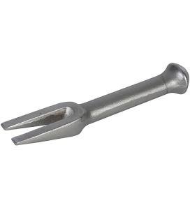

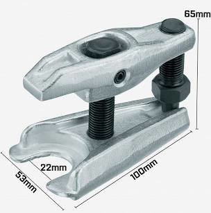

Splitter wise personally find this type
Is a lot kinder to the balljoints than this type, lot less risk of damaging the balljoint rubbers when removing
https://piezasautosclasicos.com/transmision-renault-4-5-6-y-7
They are a pretty generic tool, the measurements on photo above are equal to the one I bought which worked great for me on the 4, bought mine online, they were many options/makes etc., heres one link but you may find the same through google search ‘ ball joint splitting tool’ with less shipping as I’m in Spain to yourself, if you have a good local parts store they should also have them in the tools dept,
