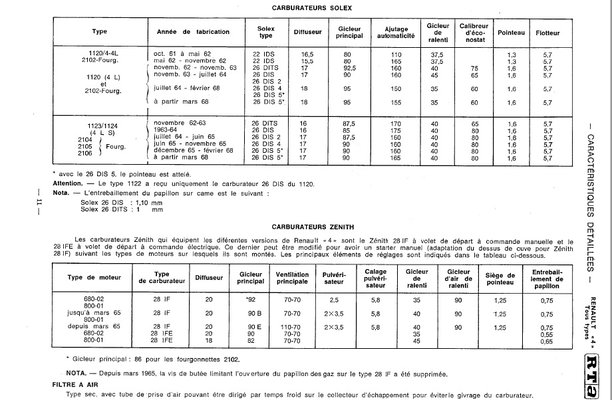

Yes it can be done.
According to RTA no. 288 (1970) the Zenith 28IF and 28 IFE were also fitted on the R1122 (R4 Super) with 680-02 (747cc) engine and R1123 and R1124 with the 800 (845 cc) engines.

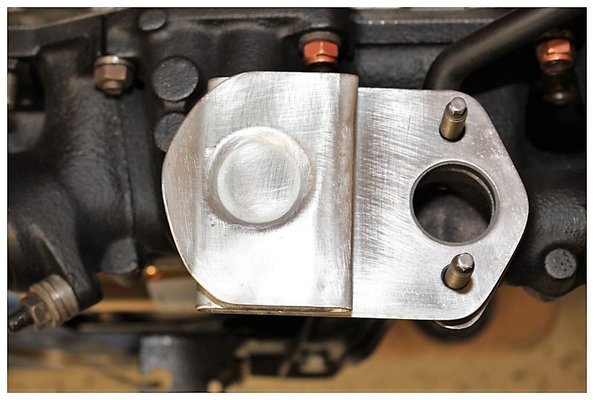

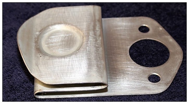

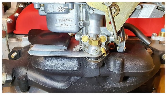

Several options;
1) In hot weather conditions obtain a Zenith 28IF - V05085 this version is special made for those conditions.
2) Apply a ceramic coating around the complete manifold.
3) Use a heatshield

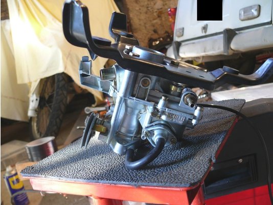

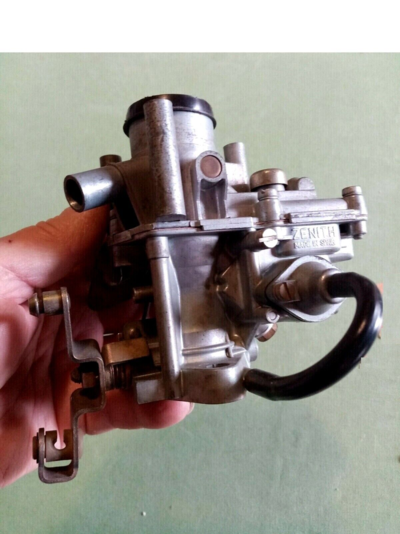

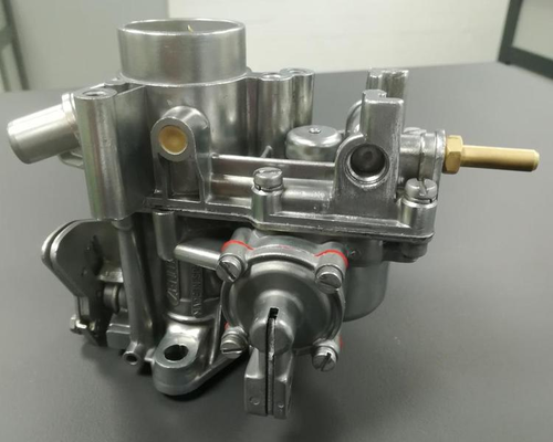

@JdeW: did this 28IF come off an R4? Throttle linkage looks different. Have you opened the additional device to see how it works and what is supposed to do?
Spanish and Portugese FASA produced R4's are equiped with those Spanish build Zenith 28IF with enricher pump. Also on the TL (Savane) with the Cléon 956cc (C1C) engine.

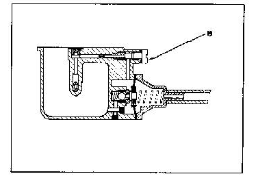

There are two versions, either vacuum operated or mechanical.
The system is used to enrich the air/petrol mixture when the engine power demand is high (throttle valve open wide but low speed.) On the other hand, the recovery pump injects the gasoline during acceleration for a specific time ( avoids the hole during acceleration) mechanical control rod generally.

Throttle linkage is easy to change.
@JdeW thaks a lot for your tips.

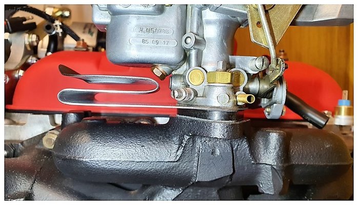

Did you have this heatshield applied?
Not yet, my GTL is still in restauration mode. But my intention is to apply ceramic coating on the complete manifold as well as a heatshield.
OK, so it's a vacuum operated enrichment device, similar to those fitted on many other vehicles. I had seen a 28IF with an accelerator pump on a FASA 1108 R4 but not this arrangement.
