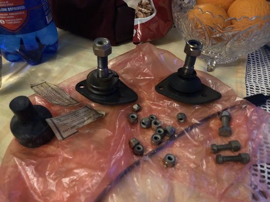

Grenuj Enthusiast Messages 215 Location Ulcinj Jan 7, 2021 #1 top or bottom ball joint?? left or right - symmetrical? I bought blindly.. accidentally bumped old stock IMG_0365.JPG 203.1 KB · Views: 10
Andy McGhee Enthusiast Messages 2,045 Location Cheltenham Jan 7, 2021 #2 They're bottom balljoints; each side is different. There's an easy way to tell them apart: the one that's 'L'-shaped (with the thread pointing upwards) is the left-hand balljoint. The upper balljoints are the same both sides.

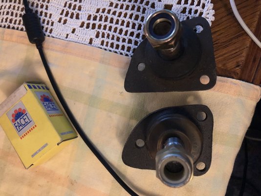

Grenuj Enthusiast Messages 215 Location Ulcinj Jan 7, 2021 #3 bottom line: two left-hand balljoint IMG_0368.JPG 216.2 KB · Views: 8
688D7/12 Enthusiast Messages 37 Location Podgorica, Montenegro Jan 8, 2021 #4 Grenuj said: bottom line: two left-hand balljoint Click to expand... Is that extra piece for sale?
Grenuj Enthusiast Messages 215 Location Ulcinj Jan 9, 2021 #5 no, storing R4 parts.. btw manufacturer is FAD (Yugoslavia).
