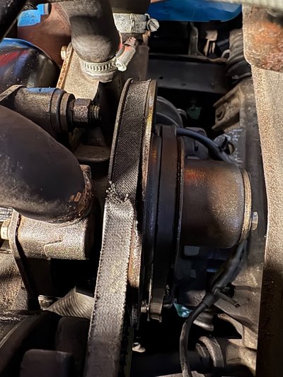

I'm off to buy a multimeter in the morning. I'll see if I've got a spare alternator and have a look at that. I think firstly though I'll clean and remove all the wiring to the alternator, see if that makes any difference.
Quick update…. Took all the connections off the alternator, cleaned and refitted. Decided to have a good look at the belt and found it has seen better days, and whilst I can’t see why it would cause me the issue I have, I’ll change it in the morning anyway. Then we’ll see how we go!IMG_1461.jpeg
Well, having discovered I didn't have the right belt in stock, I ordered new ones from DeMarco Parts, replaced the alternator belt (which had a date of 1999 on it!) together with the water pump belt and all seems to be well again!
