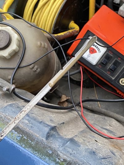

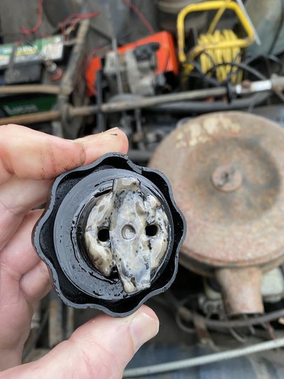

Coffee non oil in the dipstick?

Based on the pictures you've posted the oil looks clean and not emulsified, so it doesn't look as if a mixing of oil and water has occurred within the sump. The "salad cream" look to the oil filler cap is often indicative of low speed or cold running, and may be cleared once the engine has been is run at its normal temperature for a period of time.

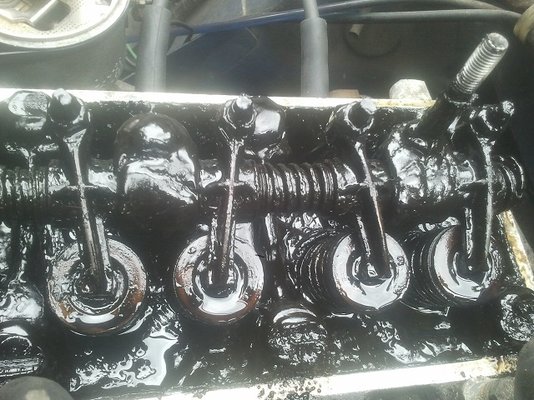

Changing all fluids is always wise after a long stillstand. also remove the rockercover and have a look, everything should be clean,
When it looks like the attached picture then the complete engine should be cleaned, and I mean completely.

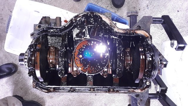

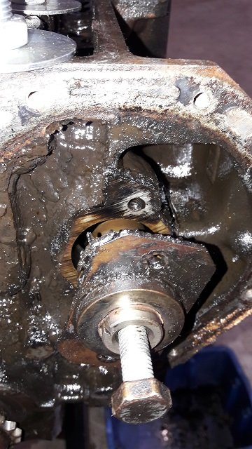

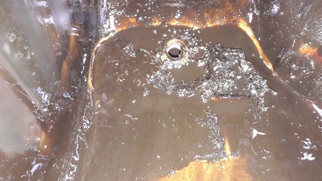

It's not to scare you but take a look at these pictures about the things that can't be seen.
Accumulation debris sump.
Partially clogged oil pump.
Distribution chain chamber and partial removed camshaft.
And then I haven't shown you the coolant accumulated muck inside the engine around the cilinder liners, coolant pump, radiator etc.
Just a small look, but a complete engine overhaul is necessary.
