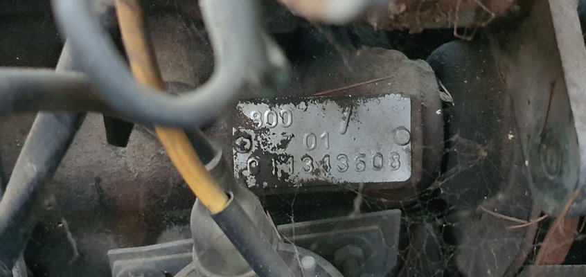

Nice to find you here! Here is attached my placard, so you are right, but next question comes... As per MR 175 I noticed in some variation of Billancourt (with oil filter) used white metal bearings while in other variation without oil filter used aluminum-tin bearings. That means aluminum-tins were "stronger" aiming to use a more "dirty" oil or is related to oil pressure? I am concerned as my engine has no oil filter but I am intending to fit one. Is there any trick? My oil pressure on idle is 3.5-3.7 Bar cold or hot without filter.
Reverse is true. White metal bearings are softer and they allow foreign matter to embed itself in the bearing material without causing any damage to crankshaft journals. With aluminum/tin - harder - bearings, any particles carried in the oil and finding their way between the bearing shells and journals, may stand proud of the bearing surface and damage the journals in no time.
Renault states that 800-01 engines were originally equipped with white metal bearings, hence no oil filter was fitted at the factory, while 800-02 and -05 engines had aluminium-tin bearings and a factory fitted oil filter. They also advised that, at first engine overhaul the blanking plate should be removed and an oil filter fitted, probably because only aluminium-tin bearings were available as spare parts.
It's a good practice to fit an oil filter anyway, and also not use modern detergent oils in these engines as they tend to flush away any grit or dirt - inevitably present in the engine - and carry it with the oil on bearing surfaces.

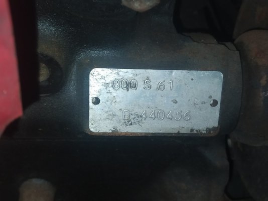

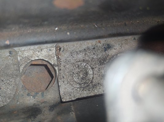

Just by curiosity, I have a 79 engine that came from a R6 (ill post the plaque later but its the one that comes with a Solex 32). Compared to a R5, does it have a better camshaft?
No, camshaft timing is the same as on the R4 800-05 engine, while on the R5 it's still "hotter" (20-56-53-23). Unfortunately, I have no data for valve lift, but you get an idea from timing figures.

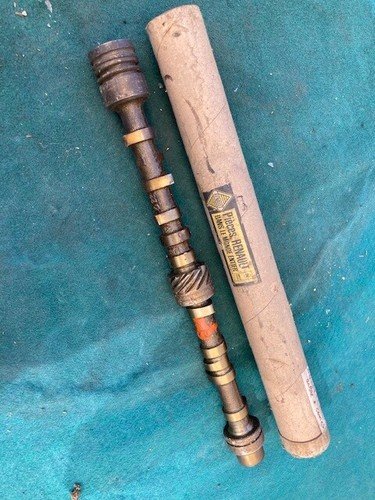

Well, to my great surprise I seem to have found myself a new old stock R6 camshaft- not unlike strolling into a forest glade and finding a unicorn poo with a set of hen's teeth embedded in it. The part number cited was 0428912900 which I believe is right but the seller listed it as being for everything from a 750 to a Dauphine and Alpine A108 as well as R4s, which would have confused people; still at least the distributor gear direction appeared to be correct for a 4/6 rather than 750/Dauphine etc, but I didn't really know if it was correct or just a standard 800-01 shaft in the wrong box. When it arrived I eagerly measured the lift and to my horror it was quite wrong- way too low- until after an hour or two of great disappointment and general moping I found you have to allow for the ratio of different rocker arm lengths (which belatedly stirred a very dim memory). So I then get measured/calculated lifts of around 7.018 and 7.844 mm bare, and if you subtract 0.006" or 0.1524mm clearance allowance from each, 6.866 and 7.692 mm. That compares favourably with the 6.99 exhaust and 7.43 mm intake I've seen on this site:
So the next time the engine comes out it's getting a little extra sprinkle of pixie dust. Now it begs the question- should I start saving for a 904 piston and sleeve kit?
When I get some time I will measure the full profile for reference, as I will be curious to see if it would be possible to regrind a standard cam to emulate it, or if they are just too different.
