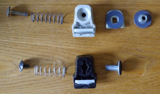

I'm looking for an older-style black window catch - the type that bolts through a hole in the glass (like the beige/white one at the top of the picture below).
I've got a black stick-on catch (shown at the bottom) but the design of the two catches is different, so you can't mix the catches with the bolts.
It seems like you can only buy the later (stick on) type now.
Thanks!
Thanks!

Thanks Nick, that's also very generous. It's really the type that is at the top of the photo that I'm after (but in black). But if nothing turns up, then perhaps I could modify the newer type (bottom of picture) by making a bigger recess. So hopefully I won't need to take up your kind offer, but I'll let you know!

The picture shows the bolt type with fixing.

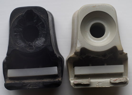

Thanks to Nick's kindly supplied window catch (glue-on type) , I've been able to make the hole on the inside of it more like the depression found in the bolt-through-the-window type, so that the black catch that he supplied now fits onto my window with the bolt-through-the-glass fitting!
