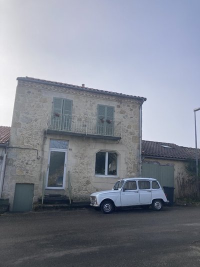

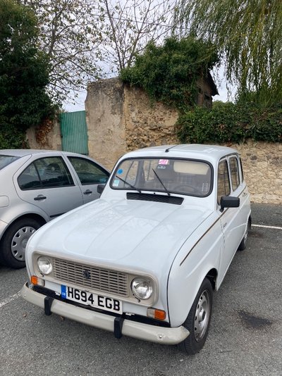

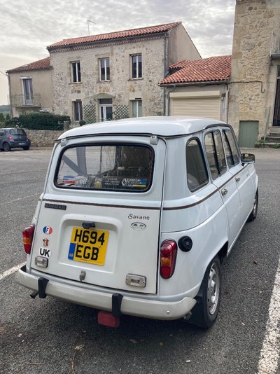

I bought Blanche (Renault 4 savane) from a classic Citroen dealer north of London. She now lives with me in the South of France. I am just putting her onto french plates. A control technique was done by a quattrele experienced mechanic. I am no mechanic. He has attached a little electric box to the coil? What is this please.He did some other bits and pieces but nothing major. Just thought I’d let whoever owned this vehicle last that it’s still alive and kicking!
