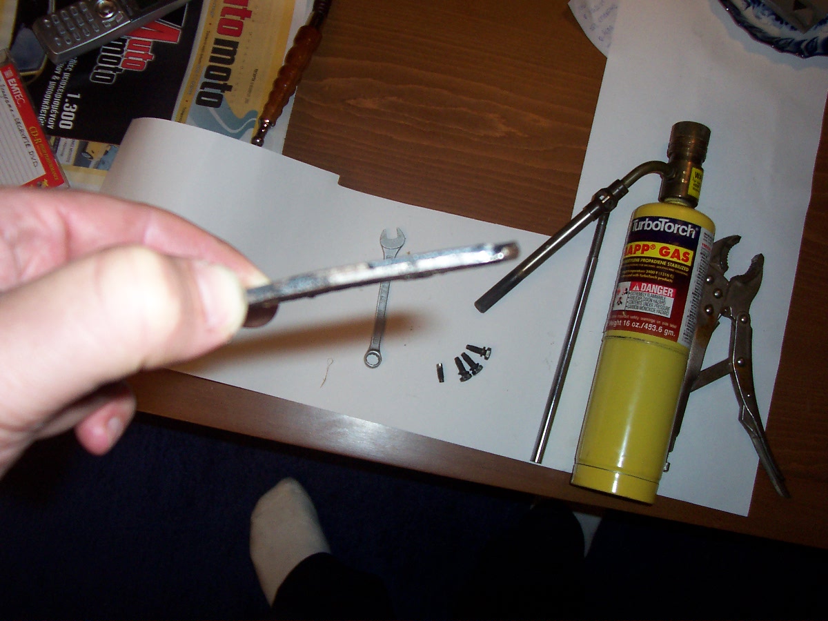

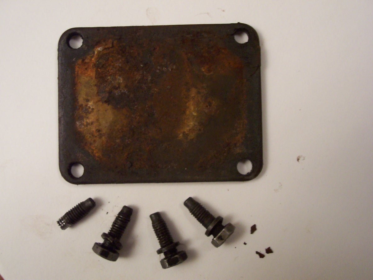

Hi,
As per previous posts, I tried to remove the blanking plate in order to replace the gasket from which the water was leaking.
Unfortunately despite my cautious moves, one of the four screws head broke !
I removed the plate which was quite attacked by corrosion and bent (see photo).
My main concern was now to remove the srew from the cylinder block (culasse), which was only 4mm out, knowing that if I did not make it I was indeep s....t.
After a lot of patience, a lot of heating with turbo torch, a lot of taping, a lot of parafin oil, and the miraculous strong pliers, I finally made it ! I am so reliefed !!.
Now I am going to flaten the plate which has slightly bent by heat, and make a new gasket from joint paper 0,8mm.
Do you suggest I put Gasket Glue also ?
To be continued....
