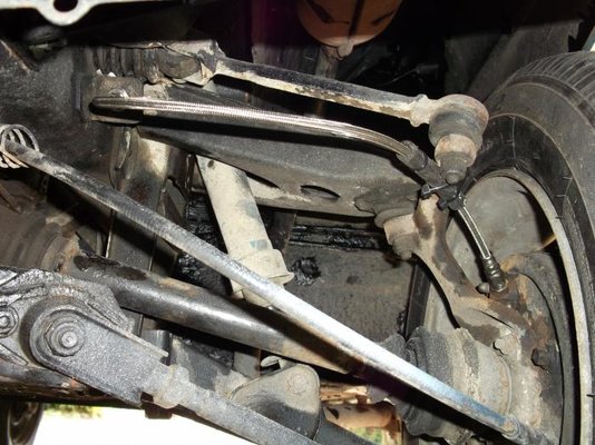

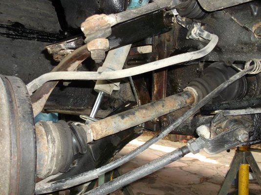

heres some pics Steve...the first pic shows how much strain there was on the original hoses, second pic shows the longer hose secured to steering arm.....what do you think?...Adrian

Ah - see what you mean now. The rubber hose should not be that tight - can't understand why if it's the specified length. Secondly the new hose is attached to the stub axle. When you said steering arm I had visions it was connected to the track rod! Even so, I still think the arrangement is potentially unsafe as the flexy is fixed and cannot 'flow' freely. I remember a car (can't remember the make) that had a rubberised guide attached to the mcpherson strut that the flexy passed through to keep it in a safe place. It allowed free movement and kept it in the correct place at the same time.
There must be others with drum brakes - have they experienced the same issues as you?
It's been at least 35 years since I last worked on an R4 with drums at the front but I can't remember having these issues with the front flexys.
Disc braked R4s front hoses have exactly the same end unions but are shorter. Maybe someone in the past put one of these on your car.
