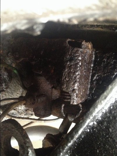

Brake pipes are the current focus of my GTL renovation - it already has some replacement copper pipes but needs new hoses and so far I haven't managed to separate any pipe to hose connections cleanly. So it now needs some replacement pipes. Now I've never previously made up my own brake pipes but was willing to give it a try and collected the necessary tools and parts. But I'm hesitating - having read various statements on the difficulties of successfully flaring pipes using DIY (aka cheap) tools.
