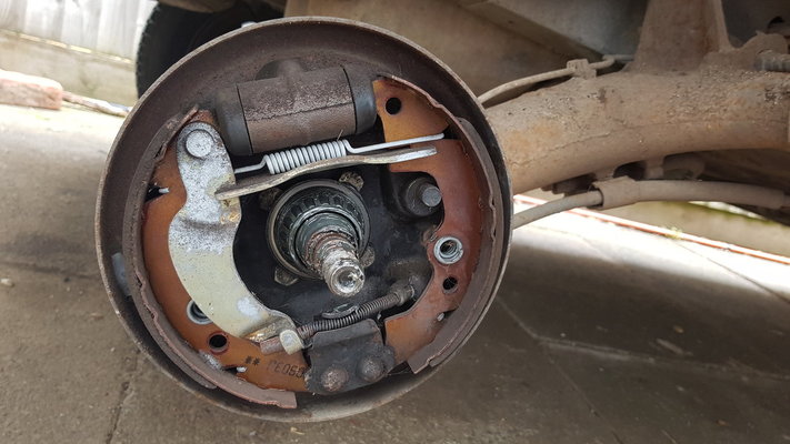

Does anyone know the part number for these rear Bendix shoes?
180mm, but with a longer lower spring than later GTLs/F6s, etc.
1982 Spanish F6
Hi Andy
Just had a look at my little notebook and have the word Spanish written next to these part numbers. No images, my own handwritten notes. I noted these numbers down as of interest. Please do not take it as gospel they are the correct ones. I suggest doing an internet search for the part numbers and seeing if they match up to your set up.
7701203438 (complete kit with wheel cylinders and fitting kit). Hopefully there will be an image showing the springs.
7701202923 (just the brake shoes).
180mm drum with 32 mm shoe width.
Best Wishes
Chris
That's brilliant, Chris - will investigate. Many thanks for looking it up - I appreciate it!
Edit: Just found some on eBay. Thanks again!
Yes - though found the shoes through equivalents:
Ferodo FSB22
Mintex MFR36
Valeo 562101
etc
It turns out that they're the same as the ones that would've been on my first Renault - a 72 5TL, which I had from 1981 to 1985!
Thanks again!
