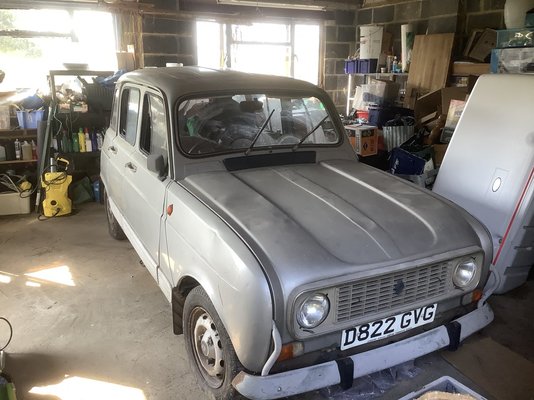

Managed to get her started and managed to move her outside and then back into the garage.
The tyres are perished and a mish mash of manufactures. I plan to put 4 new ones on this week. Any recommendations? Currently on 135/80 R13 70 T.

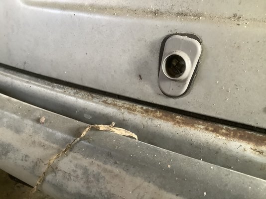

I can’t open the rear door as the handle has been snapped off. Any ideas how to replace this ?

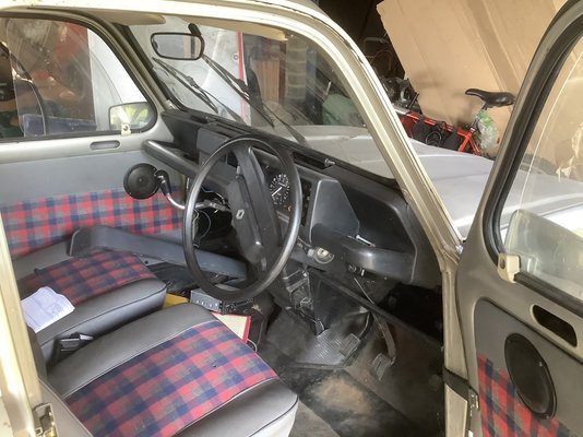

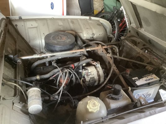

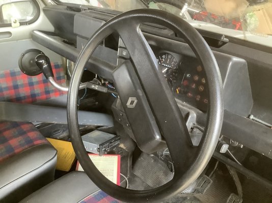

Few photos taken this morning
