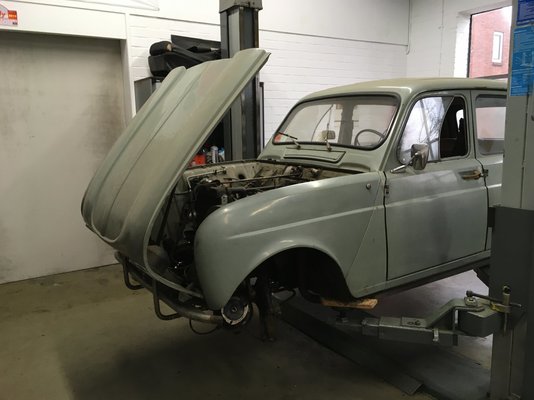

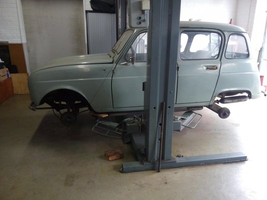

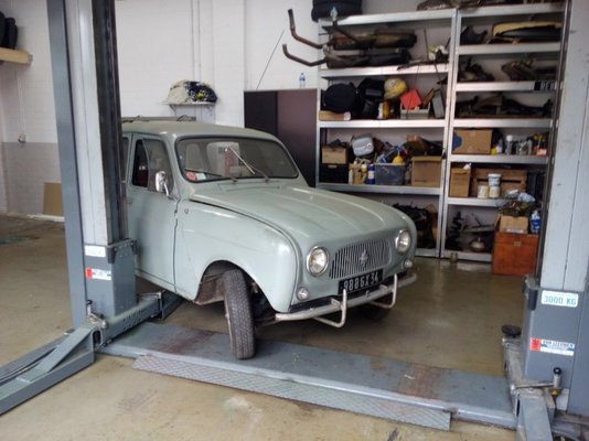

Today I started helping my friend Andrej to bring his 1962 4L Juliette back to life.
We spend most of the day taking het from the storage position on to the bridge.
And we started with removing all the old brake parts and and putting a new master cilinder and slave cilinders in.
We have also done the ball joints on both the upper and lower wheel arms.
Juliette came from Clairemont Ferrant being owned by a mechanic from a local Renault garage.
He converted her to 12v as soon as it became available and did some more modifications.
The last control technique and tax sticker were from 1994.
She has always been kept dry. She has been well cared for in the past.
It is nice to work on a well cared for car for a change. All the parts that had to be taken of came off quite easily.

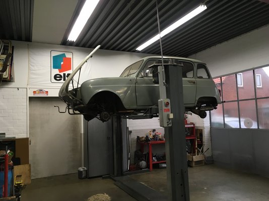

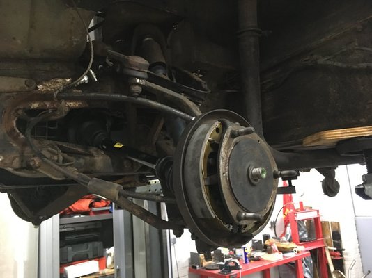

Today was a day of ups and downs.
First the downs. I hate working on drum brakes. Specially the front brakes with the handbrake are a pain. If anybody knows an easy way to attach the handbrake assembly without hailing the lord in names I will not repeat Please let me know.
Andrej bought the wrong brake hoses for the back brakes so they are not finished yet.
That was it for the downs.
Had I mentioned the that Juliette was well cared for yet. Adjusting the the brakes was a breeze. The adjustment pieces on the anchor plate were loose. On This 55 year old lady everything works, nothing is seized.
We put in two new drive shafts.
Tried to turn the engine by hand and it is not seized either.
The gearbox was empty but it is turning the wheels when put in gear.
We think that the previous owner was doing a service and then suddenly was stopped short in doing so because the whole left front brake assembly was missing.
There was nothing in the drum. We suspect that he was changing the oil from the gearbox to.

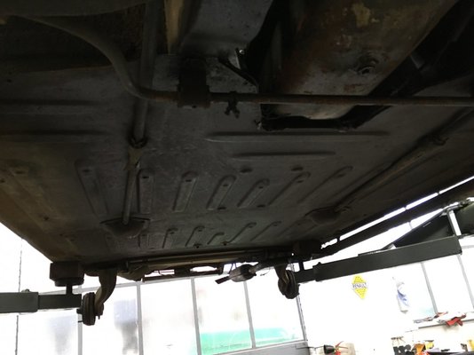

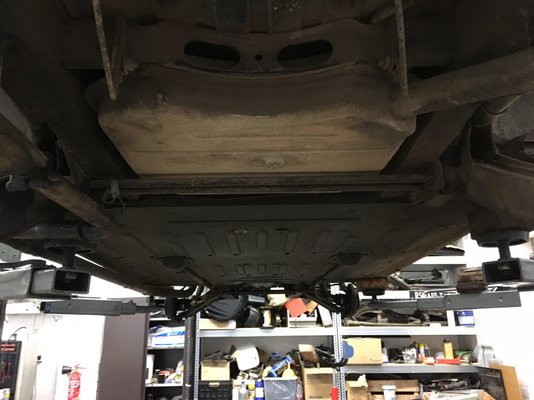

The floor. No rust what so ever. And it is untreated.
Just some dust on the petrol tank

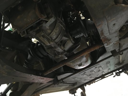

Front bake assembly with new driveshaft and blocks
A little rust on the front crossbar

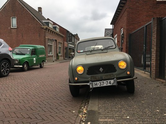

Next step, getting her imported and MOTed
CF44DCD3-77CE-4578-929A-3C6D6233F2D3.jpeg Today we did the import MOT.
I had to drive her for 20km to the MOT station. On temporary white plates.
It was an absolute joy to drive her.
It was a boring MOT according to the technician that did it.
He couldn’t find anything.
Juliette will get her new plates in the coming week. After that the road safety MOT.
