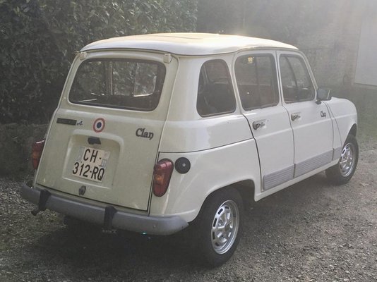

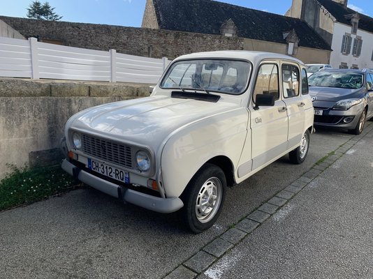

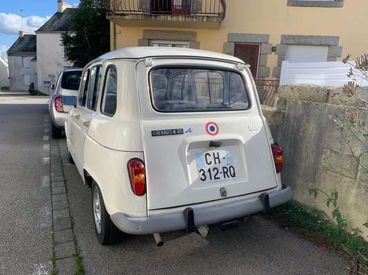

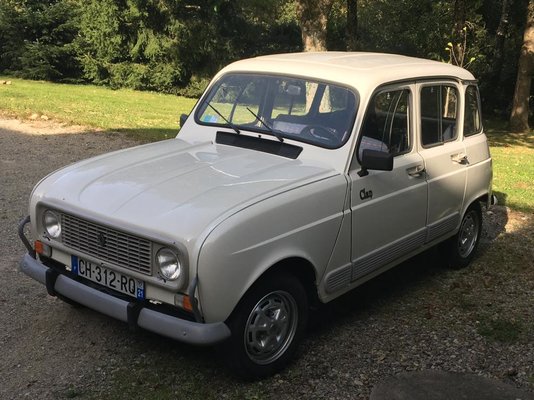

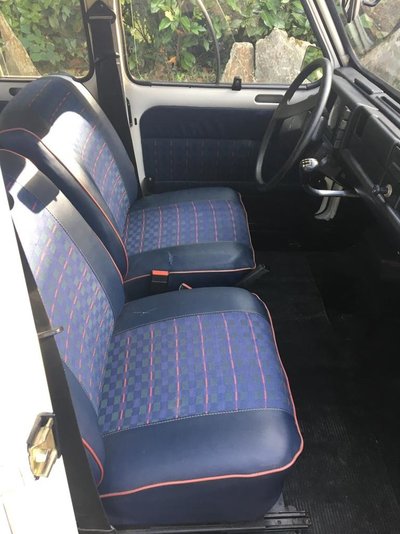

I'm now close to pulling the trigger on a 1987 GTL Clan in Brittany.
It's stock at the moment, but would not stay that way for very long if I do buy it!
It is used regularly by the current owner, has completed some long classic tour / road trips.
And he's done a lot of jobs on it since he bought it in 2012. Including a repaint 4 years ago.

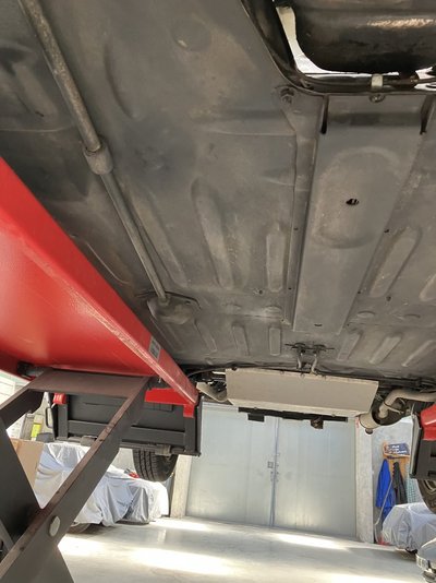

I know that the rear suspension pick up points are a common area for issues.
How easy is it to determine how bad any rust is in this area when the body is on?
My folks will be inspecting the car for me (I can't make it over to France until next month), so I want to send them well briefed!
Edwin: I saw that grey car in 4L magazine... that one is just the ticket!
If the failure reason description is accurate, it seems more like a faulty shock absorber rubber bush rather than a broken chassis. Plus, it's classed as a minor fault, which would not be the case if the chassis was concerned.

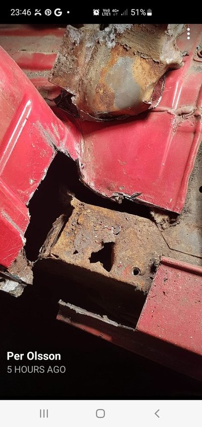

Bought an 89 R4 this year the outer suspension mountings looked a bit scabby and after looking at the tonnes of information on here I was anticipating they might need doing another tell tale is the rear floor just forward of the wheel arch any rust in this area can be an indicator to whats waiting underneath. Attached a photo not my car but mine is similar. What has caught me out is the inner suspension chassis mount they appeared to be solid showing signs of an older seemingly good repair. Wasnt til I dropped the rear suspension off complete that I've realised its all shot in fact the repair panel sections have just arrived this week from Der Franzose. Not particulalry helpful but unless there's evidence showing it's been repaired it can be a bit of a lottery. Chances are though with the car being kept in that (good condition) any issues underneath have hopefully been addressed if needed.

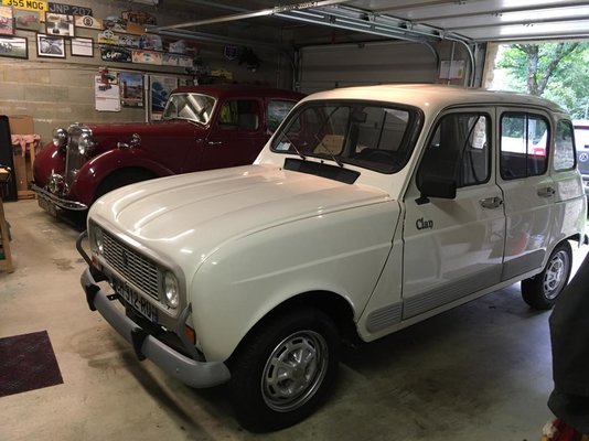

That's a nice good pristine looking R4 Clan the successor of the GTL Made from 1986 'till the end of R4 production in 1992.
Well done but keep in mind the well known things to look after that affects all the R4's regarding the year of construction!

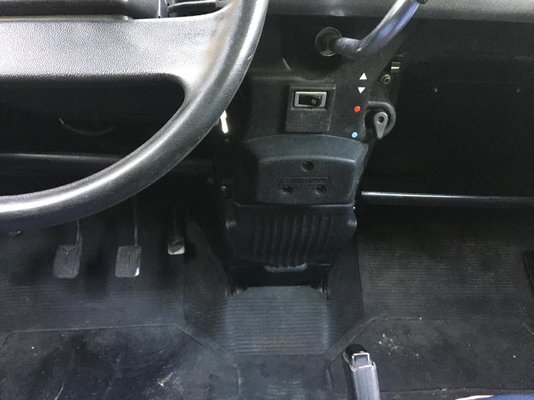

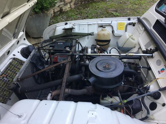

Small question; what's that sort of cable running that crosses the throttle spring?
Looks like the LHD Speedo Cable, I think.
