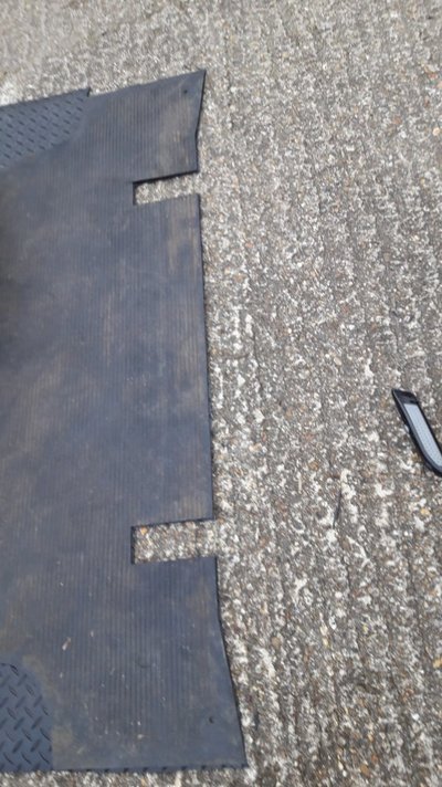

Went out today and tried to measure up the mats, due to the boots mat having curves proving hard to get a great sketch to send to Jon so we could get a good Auto-CAD drawing for the Water-jet cutter.
So got fed up and got the knife out and cut the rubber to the right shapes.
3 meters was just enough

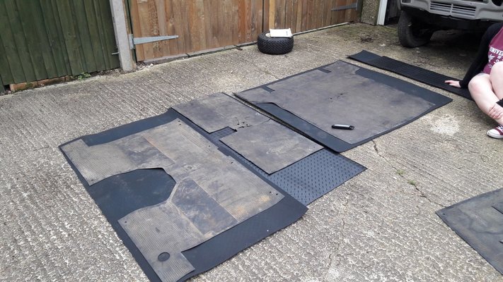

Quick cut up of the main roll

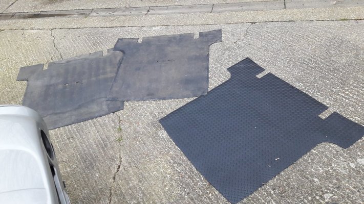

Front foot well

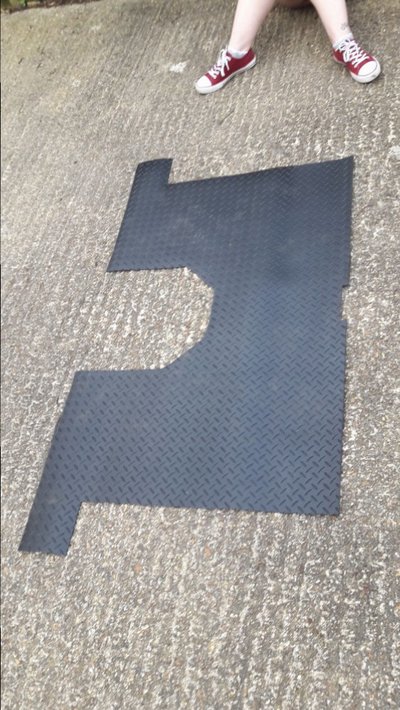

The boot piece proved tricky
But feel i did a good job

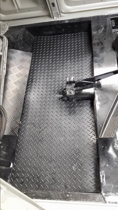

Front foot well installed

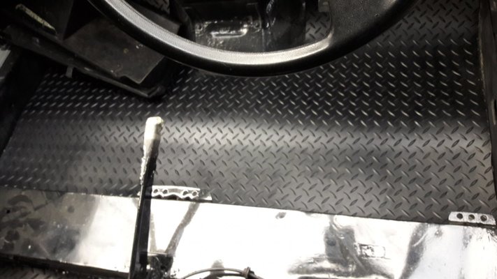

Middle, around the handbrake might need further attention but looks ok.

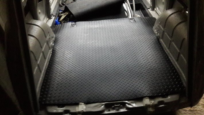

And finally the boot area.
Thanks for the offer of help Jon, and sorry matthew, but with a sharp blade, clear area and a good afternoon, sure you can reproduce my work here.
Did mine with similar off the roll material,cut in same fashion, you’ll find that after a few weeks it forms to floor contours more, especially if you run with the heater up full, sits a lot better than just off roll, if you do need to do any final detail/fit trimming I’d recommend leave it settle first.
