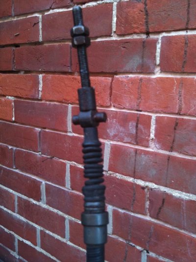

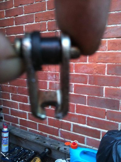

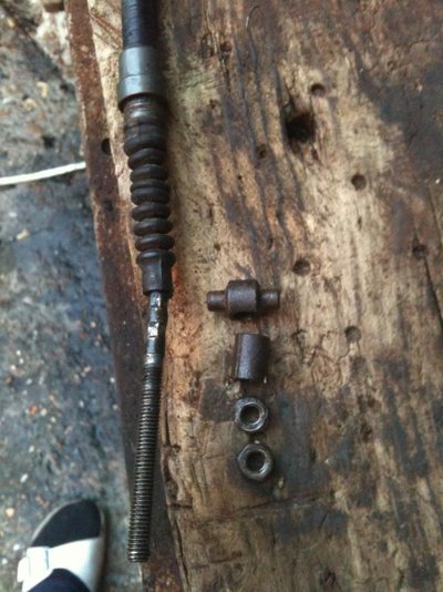

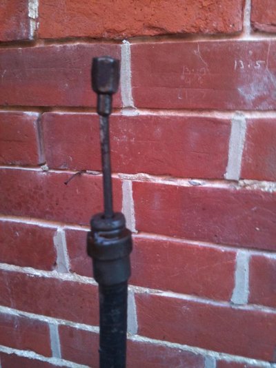

I picked up on this half way through. I think Mr Reno has got it bang on. Mine is an 85 GTL. I've attached the pictures showing all the elements, and recon the Quinton Hazel cable (which probably excludes the add-on cable-end extras) is an exact fit for length.
The last pic shows the part that attaches the cable to the clutch pedal.

Thanks Hal - worth a try then. Would any motor factor order these for me? I should imagine Halfords would be the last place to consider on this!
V. helpful having the pix.
