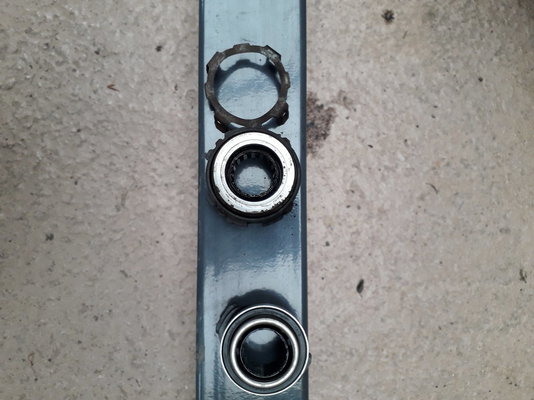

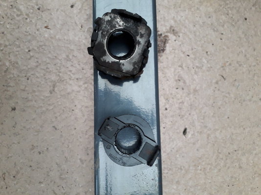

M MartinA Enthusiast Messages 129 Location Devon Apr 21, 2022 #1 Hello I have jst fitted a new clutch and find that the release bearing supplied is different from the orginal. Do I refit the old one - Fit the new one or take parts from the old one and put on the new one.
angel Enthusiast Messages 2,547 Location Athens, Greece Apr 22, 2022 #2 Fit the new one. They are interchangeable, plus they are not designed to be disassembled.
