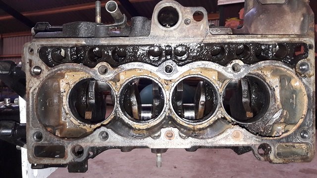

You can't see if there's any caked contamination present inside the block, that's only be seen by removing the cylinder head.
This picture shows caked silicate contamination of my Cleon engine, it's that beige stuff and very hard to remove....
As I wrote, you can't tell if it's in the engine, but you can assume it's there.
Do not use aggressive modern descalers as it will dissolve the paper liners of the cylinder bushes and then you have a real problem!!
