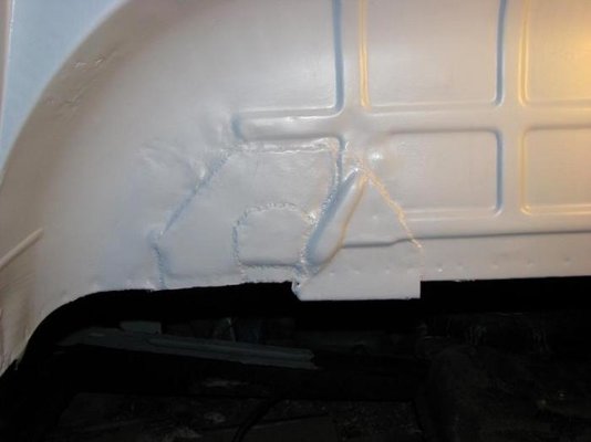

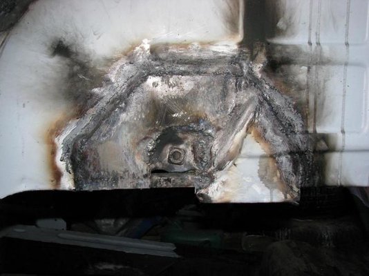

(to try and prevent rust ive welded around the edge of the whole plate.)
Depends how bad the area is for rust. At the worst I would cut out all rotten metal, repair the panel itself, then plug weld a reinforcement to the outside of the panel, making sure the reinforcement is bigger than the area that has been cut out and repaired just in case the repair fails in a crash.
Ive basically done that.
(Note: Ive used thicker metal about twice as thick for both the body and reinforcement)
To connect the panels to the actual seatbelt mount (the little bit of metal inside the car) I left the middle out of the plate and welded all the way around the inside to give it hopefully a good strong joint)
Also the reinforcement is bigger than inner repair so welds are not both in the same place.
The last step which I havent got a photo of yet was to put a plate over the middle to hide the bolt / protect the bolt from rust.
Also note unlike most of the rest of the world Im using gas welding.
(Tried MIG wasnt convinced anything I did for a while would be acceptable!)

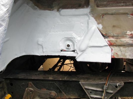

Upper Image: Inner Panel repair
Lower Image: Reinforcement repair (not yet cleaned or painted!)

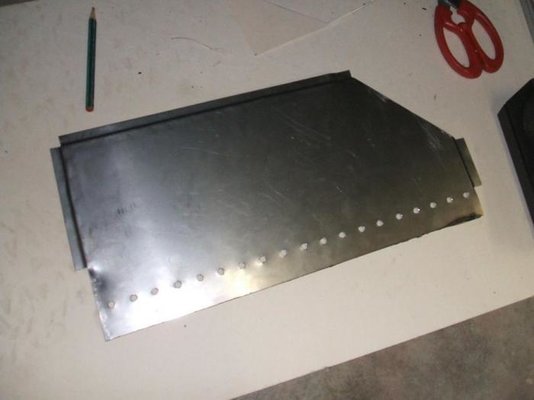

To repair mine, I decided to weld big patches at the place I cutted the rotten part:
Here is the first part under construction, only the final lower bending needs to be done:
For the seatbelts moutings, I bought steel sheet plates with 7/16 holes, they will be welded inside the luggage compartment, and the problem of double skins will be resolved:
http://www.gt2i-competition.com/PLAQUE_A_SOUDER_FIX_OEILLET_7_16°-p-20-c-375_379.html
