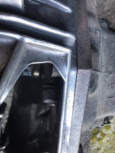

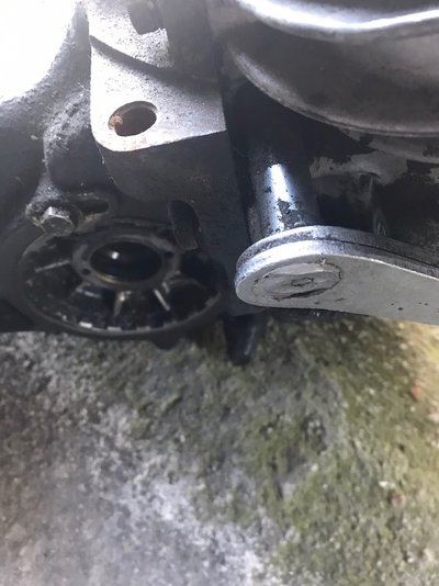

Jon,
Heres two photos of where the bushes mentioned are and accessible to spray with lubricant in case they are sticking/seizing, obviously you don’t want to be spraying clutch itself, hope you have a good result with advice given by all.
Thanks again
